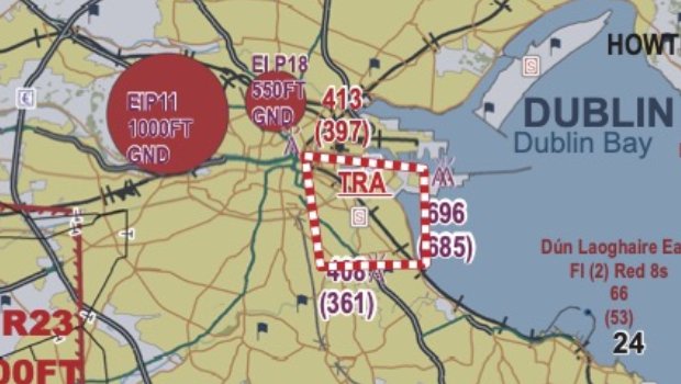

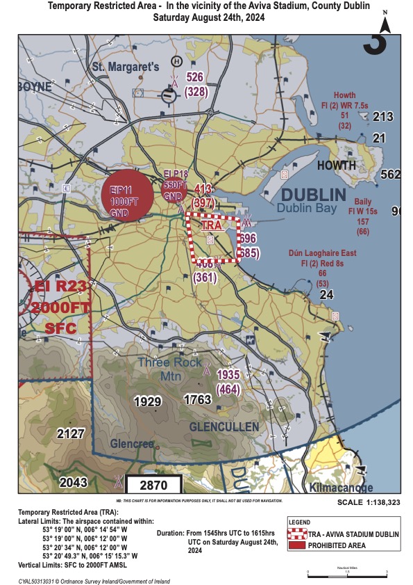

The Navigation Warning we published on Wednesday (see here) for the Aer Lingus College Football Classic Fly-Past has been updated by the IAA to a Temporary Restricted Area (TRA). While the dimensions of the original Navigation Warning have stayed the same, the activity times have changed to 1545UTC until 1615UTC.
Lateral Limits:             The airspace contained within: 53° 19’ 00” N, 006° 14’ 54” W 53° 19’ 00” N, 006° 12’ 00” W 53° 20’ 34” N, 006° 12’ 00” W 53° 20’ 49.3” N, 006° 15’ 15.3” W
Vertical Limits:            SFC to 2000FT AMSL
Duration:                    The period of the restriction shall be from 1545hrs UTC to 1615hrs UTC on Saturday, August 24th, 2024.
The airspace contained within the TRA shall be classified as ICAO Class C. State aircraft, aircraft of the Irish Coastguard Service and HEMS Aircraft Operators employed on an operational mission shall be exempt from the restriction. Subject to any decision by the Flight Operations Department of the Irish Aviation Authority to the contrary, the airspace within the TRA is restricted to use by aircraft authorised by the Aer Lingus College Football Classic Flight Display Director.
