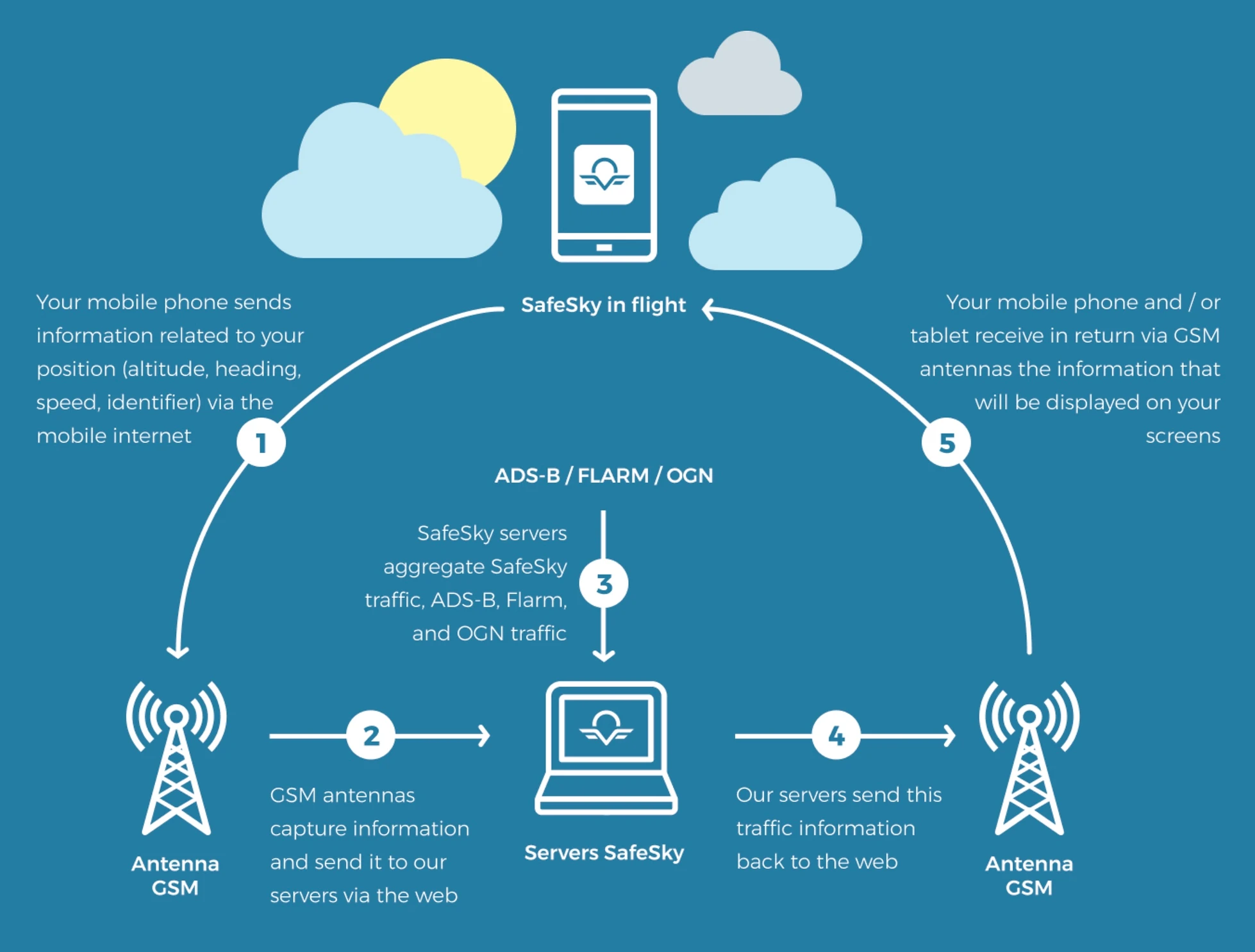

A group of six Belgian pilots got together in 2020 to address the EC problem and have developed an affordable solution called “SafeSky”. SafeSky is an App for IOS and Android that harnesses the technology in your mobile phone to send your position to the SafeSky servers, which is then transmitted in the same way, but in the opposite direction, to other users of the application. This way, you can share your location with the SafeSky community at any time.
Team SafeSky, Tanguy DETROZ, Vincent LETELLIER, Pierre TOUSSAINT, Christophe ERKENS, Paul WINDEY and Tristan FILY (Front centre)
The exchange protocol is extremely light and allows the transfer of the position even with a very weak mobile internet connection. An EDGE (2G) network is sufficient to exchange the few bytes necessary to share traffic positions in real-time.
In addition to the traffic generated by the application itself, SafeSky aggregates traffic information available on the internet, thanks to the numerous ground stations managed and maintained by many individuals. These stations allow SafeSky to obtain the position of aircraft transmitting ADS-B, Flarm or OGN signals with high accuracy. SafeSky collects this information and adds it to its own traffic to keep you informed. If you have SafeSky Premium, you will be able to use the GDL90 protocol and view this traffic in your navigation application such as SDVFR, SkyDemon, ForeFlight and EasyVFR. This effectively allows pilots access to a low-cost TCAS display which will give pilots awareness of surrounding traffic and reduce the threat of mid-air collisions.

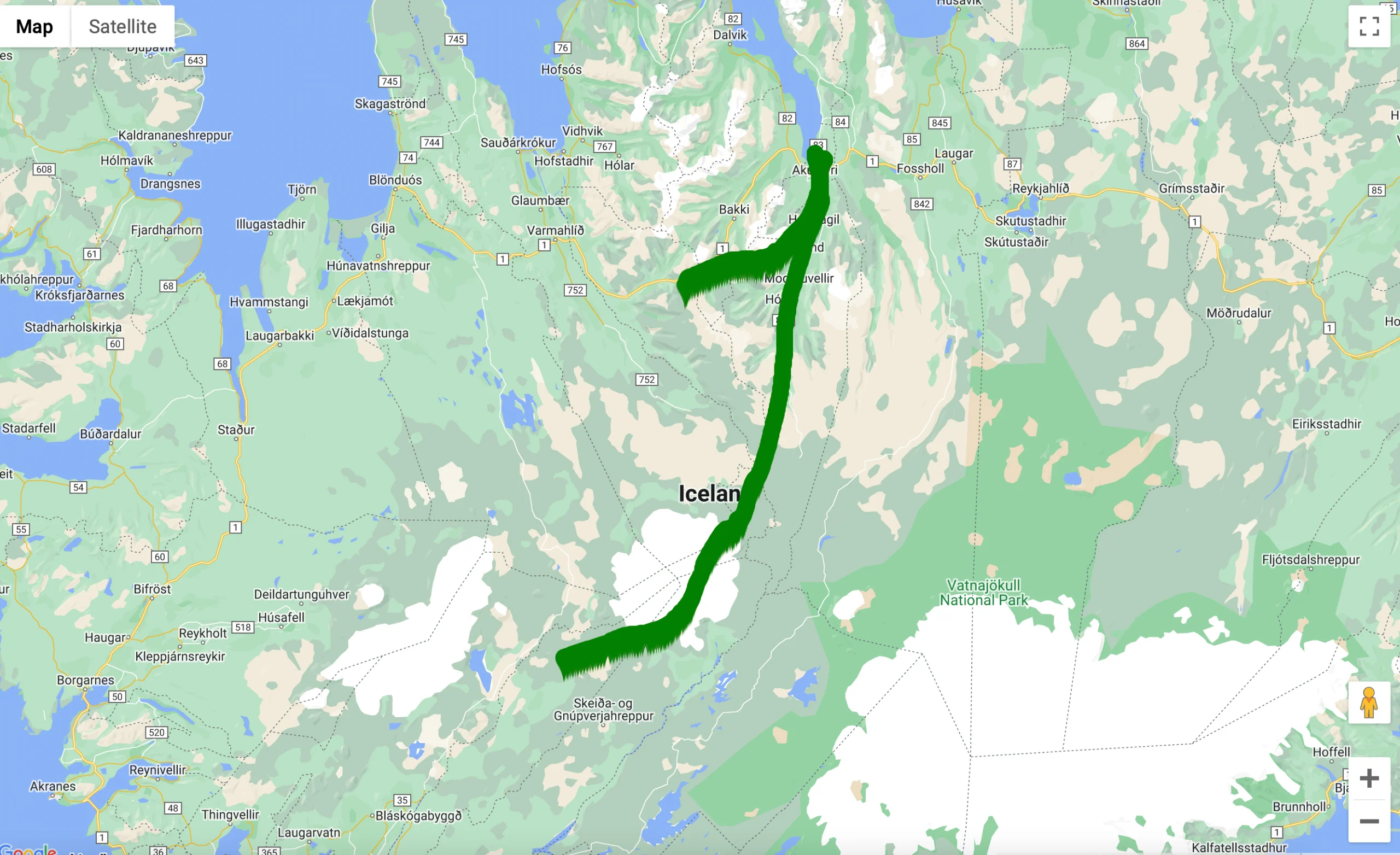

On that last point, in August two pilots encountered an engine failure while flying over Iceland. The pilot transmitted a Mayday but the SAR Services didn’t have a clear picture of the location and radio contact was lost. One of their friends who was waiting for their arrival immediately got in touch with the SafeSky team to check whether they could trace the flight and find the aircraft. There were quickly able to do this and informed Icelandic SAR to give them the last known position of the missing aircraft. The aircraft was found a short distance from the last transmitted location and both pilots were rescued.
