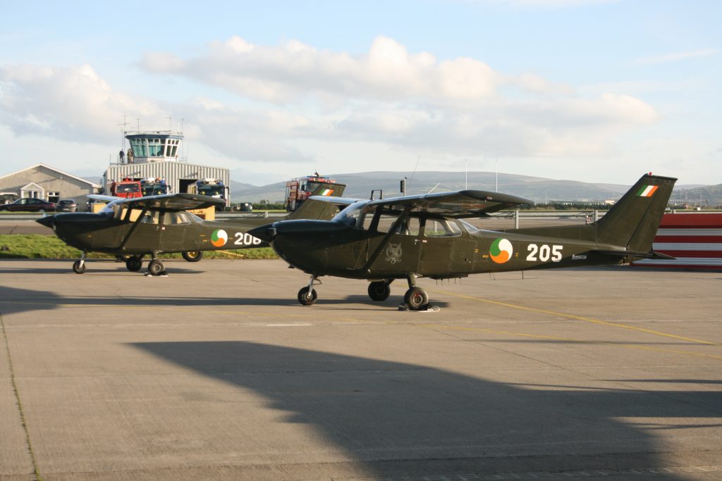

Irish Air Corps Cessna’s on the ramp in Baldonnel
