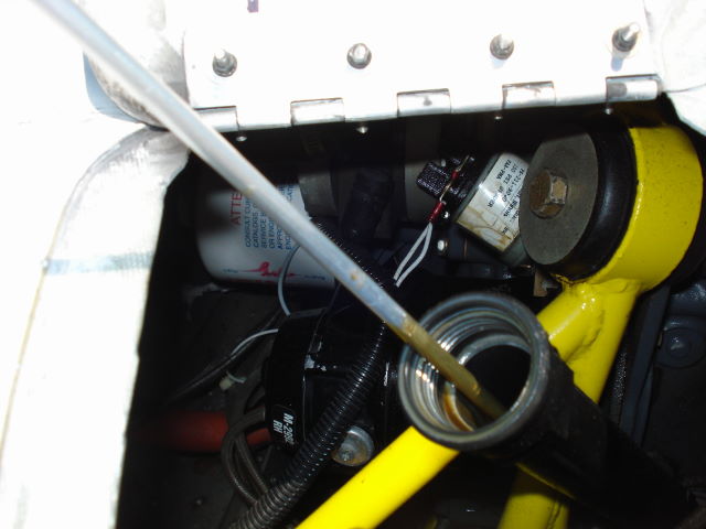

All keepers of dipsticks and bears know that the greatest sin of all is not to close the cage properly. Finger tight is good enough to keep the dipstick locked in position. Finger loose, isn’t! It may have a feeble brain, but the dipstick will never pass an opportunity to cause havoc! Thread by thread it effects its revenge for those eternal hours of boredom. Then, with one hot slurp, comes the frenzy of dipstick revenge! Hot sump oil is dumped overboard in the shortest time and with the maximum trouble for the PIC.
It could never happen here, could it? Last week a dutiful PIC checked the oil level on one of our club aeroplanes for the first flight of the day. Guess what he found? The dipstick was held on by only two thread turns. The PIC from the day before had taken the previous PIC’s word for it that the ‘oil was ok’. Haven’t we all done it?
Imagine you are sitting in the cruise and hot gunk starts to cover the windscreen as the engine parameters go red. You’ll know immediately what’s wrong and why. Then you’ll recall the real meaning of the word dipstick: an unintelligent person; “idiot”; “moron”.
