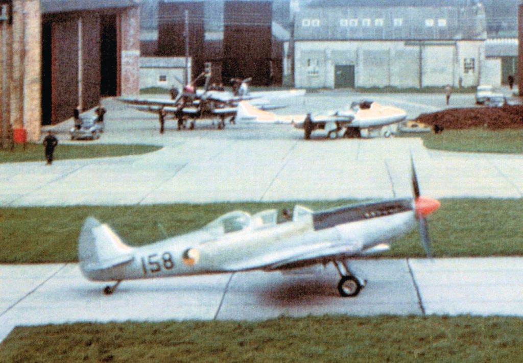

Aircraft History: Spitfire IXT G-BMSB / 158
Spitfire G-BMSB is a two-seat trainer variant (Mk IXT), originally manufactured in 1943 with serial number CBAF 7722. It served with the Irish Air Corps as ‘158’ as part of the post-war fleet and was one of the aircraft used for training and ceremonial duties. After its military service, it was restored and entered civilian operation, becoming a popular aircraft for heritage flights and public displays.
