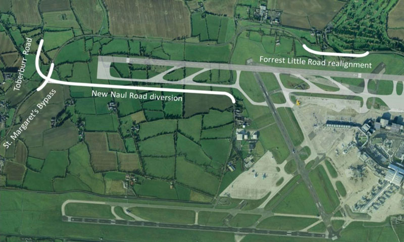

The map below provides a visual of the current permitted runway design and the revised runway design with the main runway and taxiway amendments included.

The existing plan and proposed changes to the North Runway taxiway layout.
