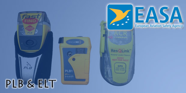

Personal Locator Beacon
Some aircraft are not required to have an ELT installed when a crew member or passenger carries a PLB. A PLB is an emergency beacon other than an ELT that broadcasts distinctive signals on designated frequencies, is standalone, portable and is manually activated by the survivors. When operated non-commercially, the following aircraft types may use a PLB in place of an ELT:
  • Aeroplanes certified for a maximum passenger seating configuration of six or fewer, or
  • Helicopters certified for a maximum passenger seating configuration of six or fewer, or
  • Sailplanes and Balloons.
When a PLB is carried by a passenger, he/she should be briefed on its characteristics and use by the pilot-in-command before the flight.
