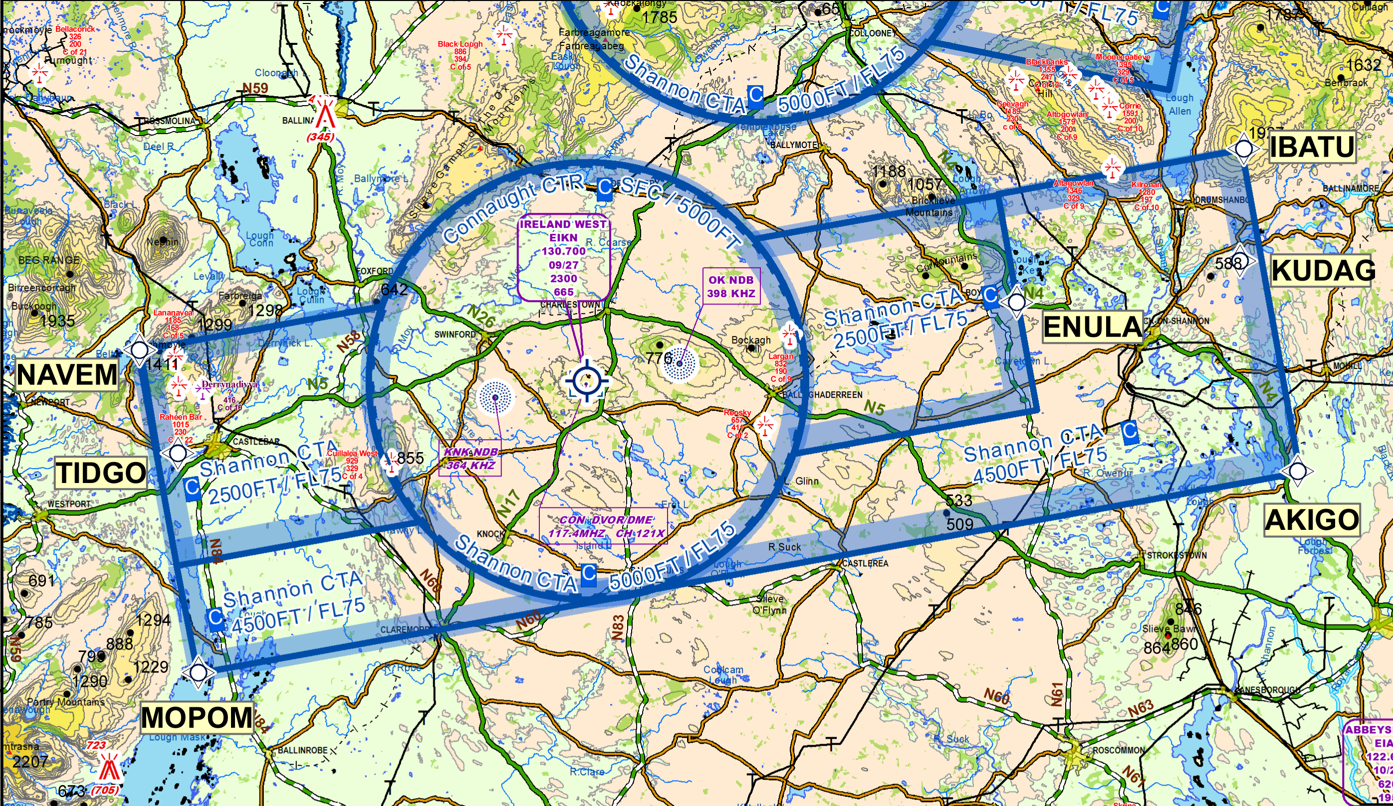

One area of concern for Shannon is flights entering controlled airspace without a clearance. This is a Key Risk Area for Shannon and all units of the IAA. Let’s take an example of regional airport zones and stubs.
Ireland West Zone and Stubs
Regional Control zones open and close as per notification through AIP or NOTAM. This means that the hours can change and also change at short notice. Once a regional zone is open the associated “stubs” also become controlled airspace. These stubs are controlled by Shannon.
On occasions we have observed aircraft penetrate these areas of controlled airspace without clearance which can have serious consequences. We ask that you adhere to the following:
  • If you do not know if a Regional Zone is open or closed keep clear of the area until you can find out.
  • If you are not sure where you are, ask FIS for help
  • Do not assume that “FIS will tell us if they see us going somewhere we are not supposed to”. It is your responsibility.
