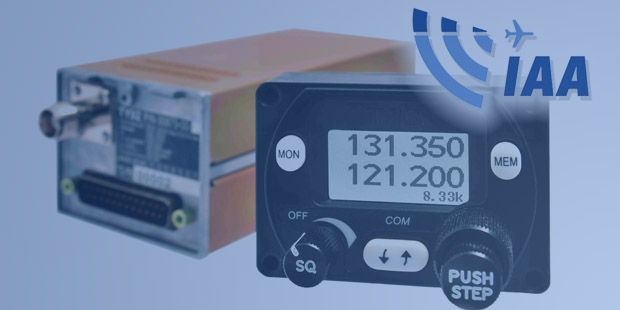

IAA issues exemption from 8.33 kHz channel spacing requirements for certain General Aviation operators
European Regulation (EU No. 1079/2012) requires that all radios used for air-ground voice communication be capable of using frequencies spaced at 8.33 kHz intervals from 31st December 2017. The radios have been required on aircraft operating above FL195 and IFR flights in Class A, B or C airspace, for a number of years. The sale of new non-compliant radios by manufacturers has also been prohibited in the EU. The final phase of this regulation is to incorporate all radios, irrespective of the class of airspace.
The shortening of the channel spacing allows for an increased number of channels to be allocated. In some European countries there is a shortage of radio frequencies available for use, which has become problematic. This shortage is called Frequency Congestion. Reducing the spacing from 25 kHz to 8.33 kHz will allow for the creation of three channels where before there was only one.

As a measure to ensure aircraft, which are not equipped with 8.33 kHz channel spacing capable radios, continue to access Flight Information and ATC Services, the IAA has issued an exemption for aircraft operating below FL195 (except IFR traffic in Class A, B or C airspace and operational control communication frequencies), and the ground based radios using the same frequencies. This only applies to aircraft operating within the Shannon FIR.
The IAA are quick to point out that this exemption will be reviewed regularly and may be revoked or amended. Presumably, the IAA will be monitoring for any significant changes whereby frequency congestion could become an issue. They encourage pilots to upgrade their radio, where necessary.
The exemption means that all pilots/aircraft owners are not obliged to have an 8.33 kHz spacing compliant radio (or no radio in Class G airspace) before 31st Dec 2017. However, there are still some rules in effect that could result in you needing a compliant radio.
  • If you’re fitting an aircraft radio for the first time, it must be 8.33 kHz spacing compliant.
  • If you’re upgrading your aircraft radio (replacing one box with another box), it must be 8.33 kHz spacing compliant.
  • If you’re applying for an aircraft’s initial Cert. of Airworthiness or Flight Permit, any radio installed must be 8.33 kHz spacing compliant.
8.33 kHz spacing compliant radios can still receive and transmit on the same frequencies as the 25 kHz radios, and a few more. However, using a 25 kHz or 50 kHz radio where 8.33 kHz frequencies are used could result in you inadvertently stepping on adjacent frequencies; so be cautious!
