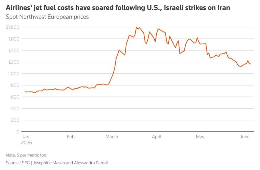

Jet fuel price
Jet A1 Kerosene had roughly doubled since late February, and as of mid March IATA were reporting $175 / 179 per barrel of Kerosene on average. Whilst this price has eased the continuing US-Iran impasse over the Strait of Hormuz will make jet fuel price uncertainty long lasting.
Jet fuel price is predicted to remain disproportionally high relative to crude through to next year 2027. The difference is known as the “Crack Spread” and is due to reduced refinery capacity plus supply chain bottlenecks, a ‘higher-for-longer’ scenario is playing out. Recovery to cheap JetA1 will take time
Across 61 European airports the rise in fuel book stock was 62% in April compared to April 2025. Airlines that have hedged fuel and have access to hubs deep storage facilities will get through the summer and autumn. Once the hedges run out the full market price of refined kerosene will hit.
According to S&P Global Energy JetA1 production is down some 16% but tradeable volumes down an estimated 46%. The dynamic is companies and governments are protecting their own fuel supply and not exporting, just-in-case the US/Iran stalemate continues.
